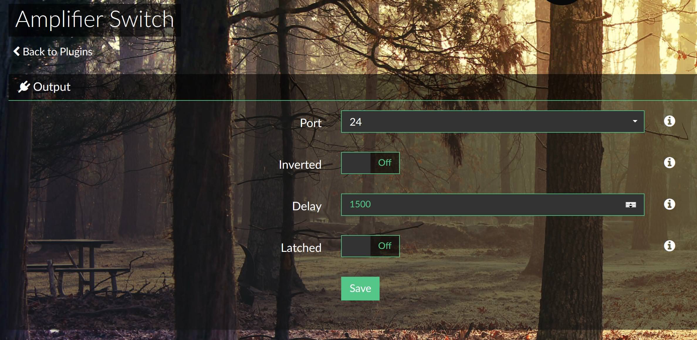

@Fightclub,
I had some time today, implemented relay pulses as well, but wanted to check with you about the UI naming nomenclature before submitting a PR.
I added a simple toggle, that when enabled gives a ‘pulse duration’ setting
changes here
Oh, I need some help with the DE translation, mein deutsch is ok, aber mein technisches Deutsch is nicht so gut!
What would the ideal translation of pulse width/duration?
Technically, since these are all just different relay types, would you prefer a drop down to select the relay type?
That way we can have : Normal, Latching, Dual_Latching… etc
Cheers!
