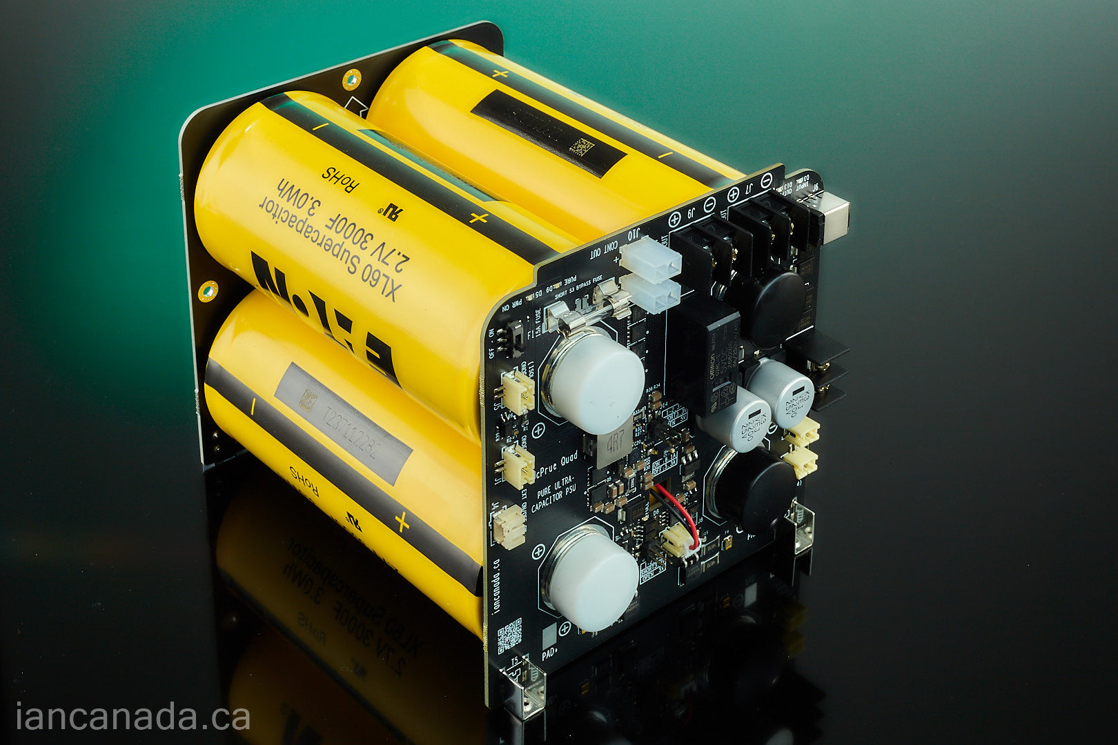

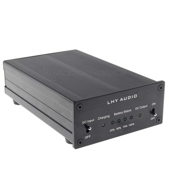

Has anyone tried using battery power supplies? What are the sonic pros and cons?

Depends on what you mean with battery power supplies.
If you’re talking about the battery packs to boost your phone, it’s not an good idea.
These battery packs often use boost converters that introduce electrical noise, which can leak into the audio signal path, especially problematic for sensitive DACs and amplifiers.
On top, if your using a rPi5, you can’t use the USB-C to power the devices (lack of USB-C power negotiation), but you need to connect it straight to the GPIO, which can cause a lot of issues.
Building an array of rechargeable batteries, can only be done with a regulator (5 * 1,2V = 6V) to lower the voltage. A regulator can again cause electrical noise.
