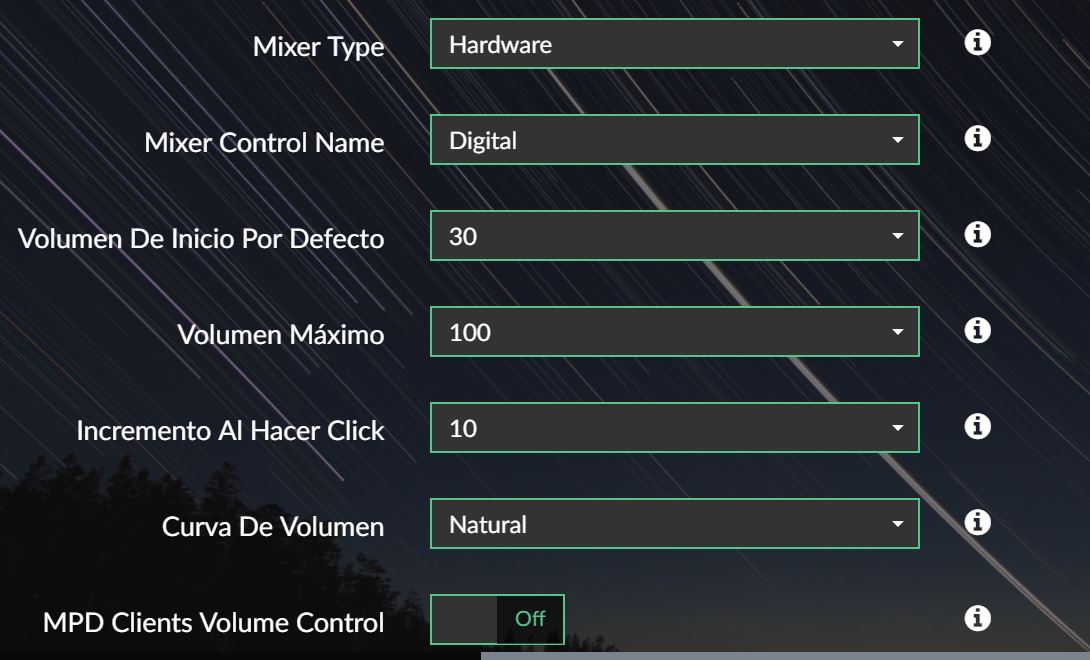

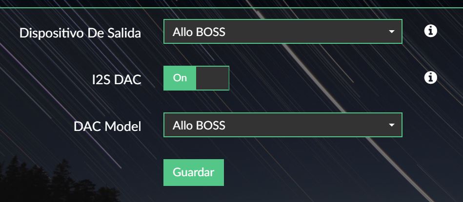

Hi Michelangelo, I finally got my Allo Boss DAC.
But it does not work … it has no sound. In the Playback window, everything is correct, working normally.
Use Rasp 3 and Volumium 2,185. The DAC starts correctly, the settings appear to be correct. I disabled all the plugins.
I am very disappointed, I do not know what to do.
Can I be doing something wrong? Is there something obvious that I’m forgetting?
Regard
Daniel
Well … I reinstalled Volumio, it works perfect.
The first impression (tomorrow I try thoroughly) was: Wow !!!
