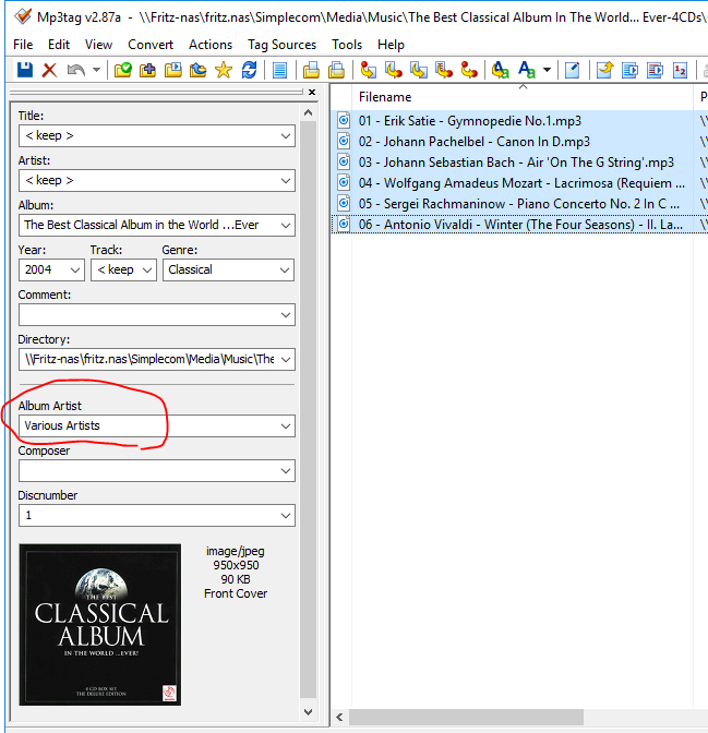

I was only having cue and album play issues in compilations. I resolved the issued by adding or changing the metadata for “Album Artist” so that it appears as “Various Artists” <-note this must be written exact. Using VA, va etc did not work.

here is a screen shot of my mp3tag… https://drive.google.com/file/d/1e2b37NBjz4wPm1-UqkOuRwS9EMn51RG4/view?usp=sharing

update: tried updating mp3tag but still no way to play album keeping track, in the tags and in the title, of the different artist performing each song/track… the only way is to put in both fields artists and albumartists the same value (Various… or Various Artists… or whatever… ) that means all the info about artists are lost
